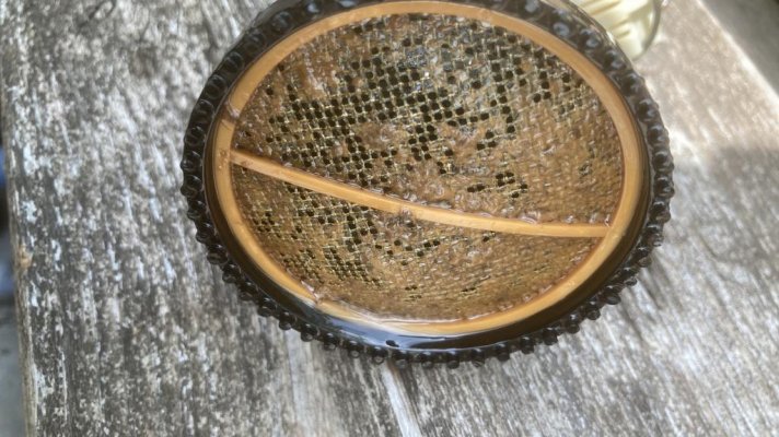

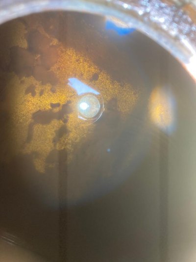

well, here a look at how the contamination is presenting itself, the filter comes later on.
2,401
2,541
X2. get some Bio-Cide or what ever the stuff is called and what ever they use in France to kill off the growth.
Fuel tanks not kept full and sitting around for a long time, these little critters will start to grow.
Condensation can occure in particially filled tanks, and a combination of that and right temperatures can cause the problems.
That is one plugged up Shower head.

yep...
as far as my info get's, I'm supposed to give a shock treatment with that stuff, and just get that in the tank, and run with it, correct?
and then it is supposed to dissapear?
Tbh, I haven't a clou how and with what I should clean that tank and the shower head? any of you?
