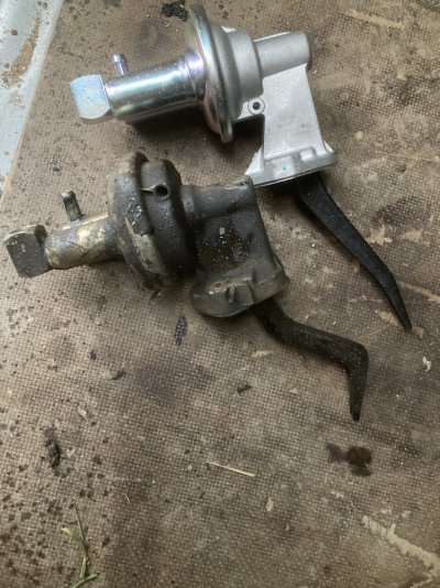

I guess you can see which is the new one?
I do wonder, that long lever, it's different between the old and the new one.
Does it make a difference in it's function?
all other connections are the same.
at this point I stopped anyway, it's raining cat's and dog's over here!
2,401
2,541
Both levers work, no difference.
Just make sure the arm is under the Cam
when you install it.
I changed out the steel pipe to the Filter with a piece of 3/8" hose several years ago.
Which ever one you use, fill the Hose/Pipe with fuel first, and make sure the Filter if full. Cut`s down on air in the system.
