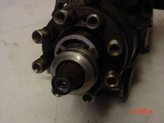

Did you replace the internal filter in the injection pump ?
I'm not sure on this filter above , but thats what I'd try ?
I've had that one clogged from contamination !
HHmmm, I'm not sure about that, could be? but would (if this one is contaminated) this pump still pull a vacuum at the filterhead? I'm not sure?

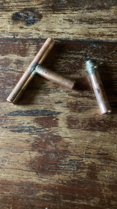

Busy making some gadgets to measure some pressures and flow volumes.
all your fault, motivating me to see how everything is as close to spec's or not?
see if it works.
