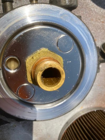

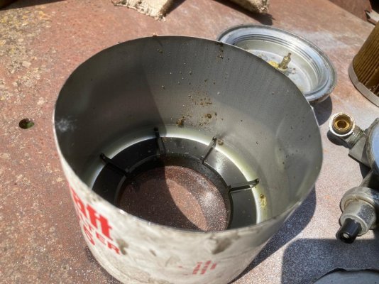

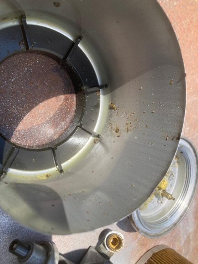

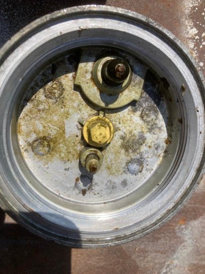

So, Today I got around to cut the filter, it doesn't look like much, but it defenitly spoiled my week, to clean everything etc.
At the filter base where the sensors are, you see the slight brown layer, I think that's the "pesky bacteria", that is in the tank as well, and in the diesel entry line from the filter head etc.

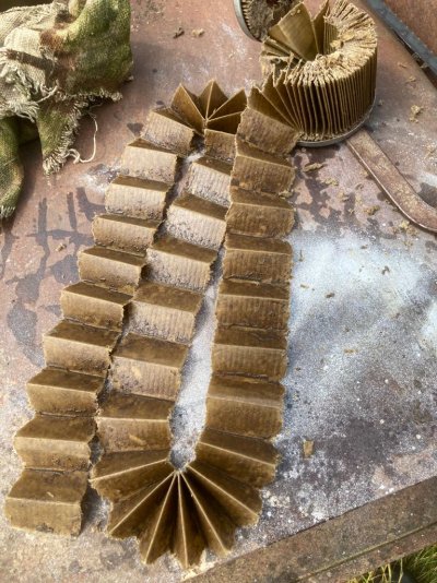

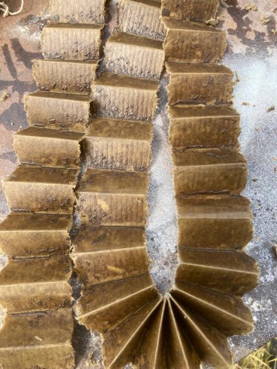

some more:
If you look at the paper filter itself, it looks not bad? I was suprised to see that, until you look a bit better on the unfolded "harmonica", there you see that the whole filter media is covered with this sticky tough layer of lightbrown "goop"!
