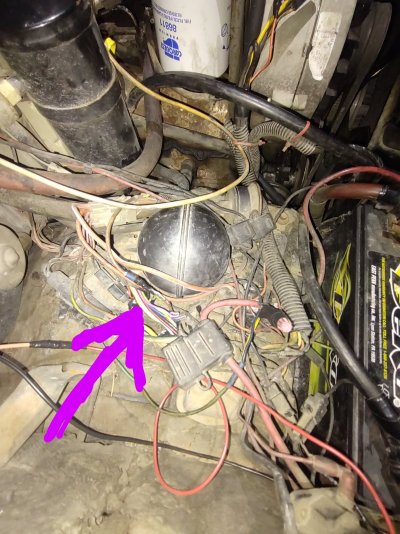

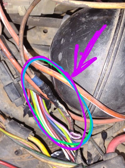

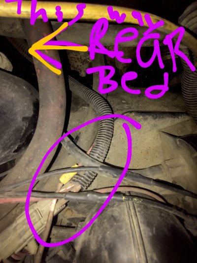

This wire caught heated and melted. One is green with red stripe. Other is red. Both are wired to the same red wire running down and back towards the rear of the truck. Bought used. Not my wiring lol. Any ideas??

Wire only over heats when ignition is on. So it's not a constant power supply

These wires aren't supposed to be connected. At least they aren't on my 1985 F250. The green/red stripe wire goes to the voltage regulator. At least, on mine, it goes to where I removed the regulator while doing the 3G alternator swap. I couldn't tell for sure where to red wire goes to. It was chilly and I'm a big ****** when it comes to the cold.

So I should just remove the wire all together?

I would just terminate it/them safely. Just in case...
As @Farmer Rock said above, just crimp an insulated butt connector onto the end, and then wrap the whole thing in tape. I would follow that with a nylon wire tie or two, just to be sure the tape doesn't come off.

I think that you should separate them first. Then you should try to determine where they each are supposed to go. You may need both of those wires. You'll need help from a wiring diagram unless you like tracing out wires, which I can't stand. The diagram will also tell you where the smaller wires is supposed to go instead of where it at now, assuming that you can't tell by looking.
