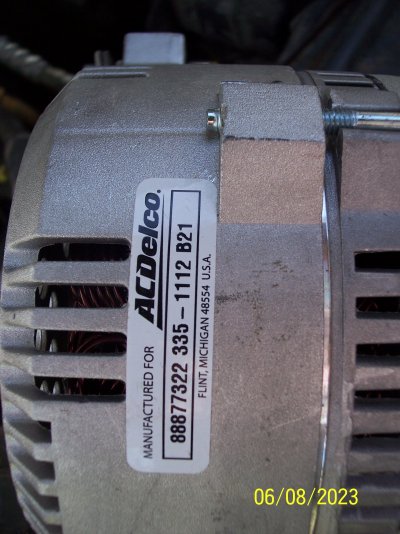

Except.... It's NOT the correct part.
This is the smaller 60 or 70 or whatever amperage alternator. The 130amp alternator has two vent holes here and is PHYSICALLY LARGER.
As you can see, both are clearly labeled as 334-22
So this means that I'd better check my AC Delco alternator
I did finally remember to check my alternator today. It's supposed to be for a Taurus, what year/engine I don't remember. It does only have the two large holes, but it's physically smaller. The best that I could measure says that the alternator on my truck is about 8 1/2" between the bolt holes. The AC Delco is about 7" between the holes so it probably won't work either.
You might be able to use it. I'm pretty sure that's the same one I have on Tank right now, if I remember correctly I had to buy the ambulance package belt. I don't think I had a vacuum pump at that point so I couldn't tell you what belt you'd need for that.

Welp... Third time isn't the charm after all.
My only guess is the very first alternator they sent me a year ago was wrong but happened to be the exact one I needed? Seems a bit unlikely but that's what it's looking like. I may bug my friend at the local parts store to see what they might have in stock to measure it but this one is going back. The "old" one and the "older" one will both be going to the local rebuilder if Powermaster doesn't have what I'm looking for.
When I was talking with Powermaster it was looking like they only have the 7" spacing mounts, the one I need is 8.25"ish. I'm going to email them tonight and see what they say tomorrow. I could use the smaller one if I had to but I'd rather not try to figure out what belt I'll need. I'm tired of fighting with this mess. APPARENTLY there are three different sizes of the two bolt mount 3g. The "large case" and "small case" must both come with 7" bolt spacing? I don't know, I'm finding conflicting information online which is frustrating me even more! o_O
Pictures finally got approval on my battery cable mess. I think the post was buried by the time it got approved so nobody saw it LOL
@IDIBRONCO For what it's worth... Tank DOES have the smaller 7" spacing alternator, I checked today. I didn't realize it wasn't quite right because I didn't have the vacuum pump belt to worry about. I noticed the stock alternator belt was too long but just assumed that was because it was a 3g alternator not a 2g.... I did notice one of the case bolts wants to hit the fuel filter bracket but it wasn't too bad and I managed to make it work with the ambulance package belt (Gates 9570HD) if my memory is correct. I seem to remember buying that alternator for an old 86 with the 351w and ended up abandoning that project. I reclocked it myself to fit so you might not have the same trouble I did.

Picked my alternator up from the rebuilder today. $103. I had kept the old alternator when I put this reman on and it's a good thing I did. The shop said it (reman) wasn't worth repairing, too far gone, but luckily he was able to take a couple parts from it and make a good one out of the pair.
