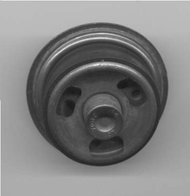

... Waiting for new champion radiator to show up and get everything back together for a final test... Oh and another note the ball in the tstat housing was rusted in place... Got it broke loose and functioning properly
Any grocery store sells steam distilled water in the 2 gallon jugs, pretty cheap, why ruin a Brita filter, there not cheap. And shake the t'stat neck to hear that the ball rattles. That ball is a must have, acts like a check valve, open to let air bleed, then closes when liquid hits it. If the ball isn't there then coolant will by pass the t'stat continually, then the t'stat can't do it's job right.
