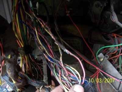

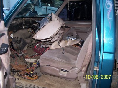

yup my IDI burnt up the dash harness on my way home the other night.cab filled with smoke.pulled over into an empty parking lot,shut down and opened the hood.i looked under the hood and saw something glowing,looked like the wireing for my lightbar.looked under the dash and didnt see anything as it was too dark.so i drove home with no tail lights with my strobes on.lost my dash lights shortly after takeing off again
on the way to work next morning i lost the radio.half way to ehre i was going i lost the speedo.tranny wouldnt shift at all.i tried to shift it manually but when it hit 2nd it just slipped.tranny temps went up into the 300* area.so stopped to let it cool down.not good for the new tranny :eek: left it in first and babies it to a parking lot.found 6 blown fuses and a whole bunch of burnt wires.

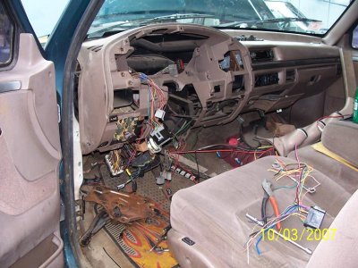

couldnt find a new one anywhere.i tried to replace the taillight firewall connector but found it burnt all the way up into the dash.i ended up takeing the harness home and cutting out the burnt wires and replaceing the burnt sections one at a time.find the cause of it.when i put the tranny crossmember in it pinched the tail light wire.its all set for now but id like to get a complete harness to replace it with.just cuz i like uncut wireing.cookoo
any ways here are some pictures for your viewing pleasure

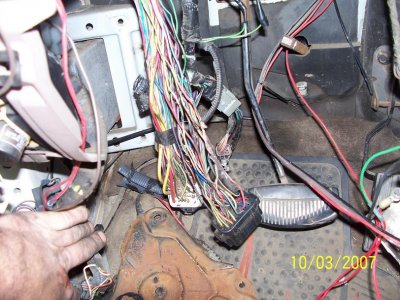

oh and check a part of your own wireing.look at the 3rd picture.see the whit bracet that the aluminum braket bolts to under the dash?one of my main battery feeds to the fuse box was worn through on that white braket and shorting out as well.

sorry to hear about your luck, glad your truck didnt burn down. looks like a busted knuckle in pic 3. make sure you solder and heat shrink the wiring, if you do a good job (which looks like you are) your wiring should be fine.
i agree though, i hate having hacked wires. it really makes me cring seeing what other people are running around with sometimes.

not really except for the tranny a couple months ago and the dash wireing.other than that its been pretty much problem free for almost 6 years.the burnt wireing was my own stupidity.the harness for the rear lights got pinched between the tranny crossmember and frame when i put the tranny back in.never thought to make sure the wireing wasnt gonna get pinched there.
but everything is soldered and shrink tubed.and somehow even my dash lights are brighter than they used to be!!:confused:
