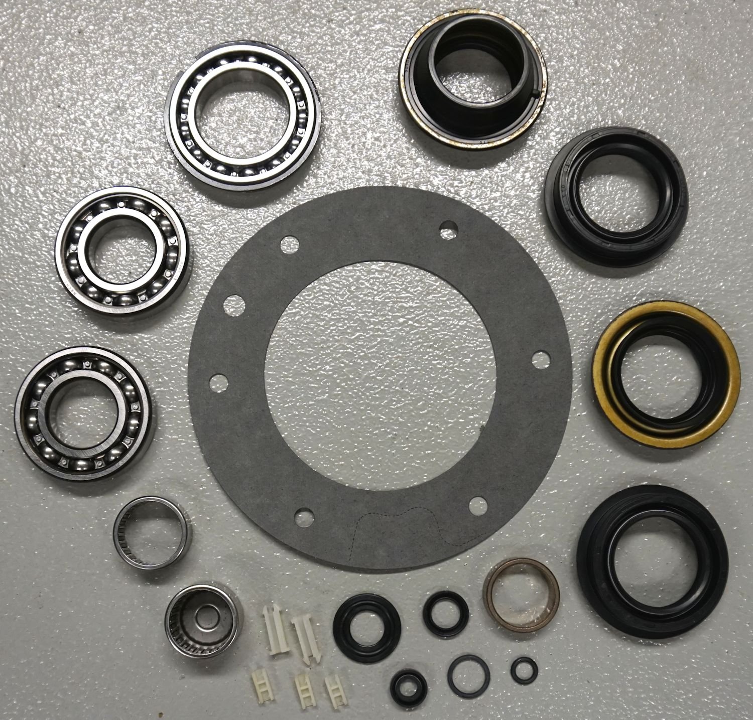

I definitely recommend the oil pump mod! When I rebuilt mine the keeper arm had worn about 60% through the rib in the case. I also had to get a new planetary since mine had too much play. Definitely let us know how yours goes!
Hey, sounds like you got everything rolling along...
Didja look closely at the forks ? They have molded plastic or replaceable inserts...I can't remember...but it would be good to carefully check them out to see if the plastic is brittle. Just tryin' to be helpful.
