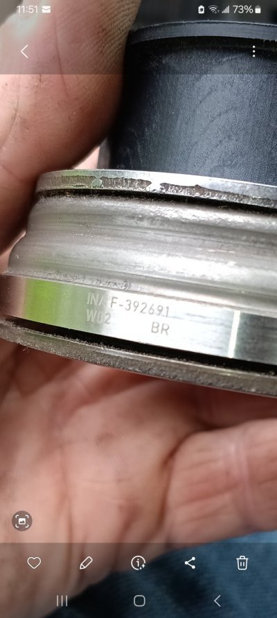

Got my LUK clutch and flywheel kit delivered today. I was ready to pick up a name brand TO bearing but I was happily surprised to see this in the kit.

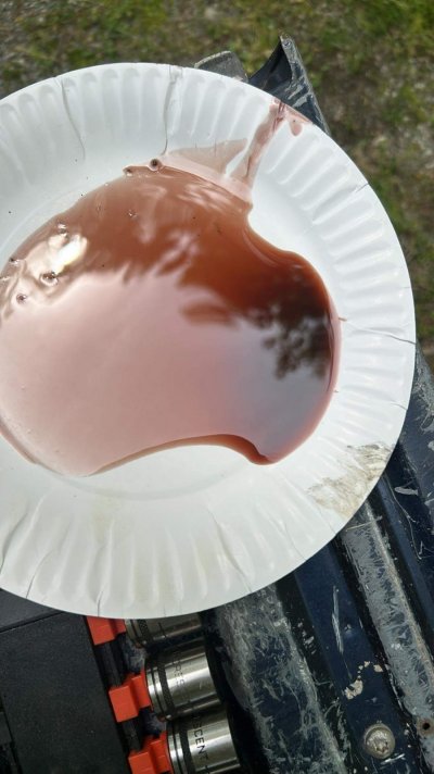

This is the response I got from the seller after asking to pull some fluid.
“sorry man the fluid was already pulled i don’t have any pictures of it. I can try and get a little for you. I totally get it. i TOTALLY understand as it’s a long drive so i will do everything i can for you and get you what you need to make sure you’re getting something good”
Not sure why the fluid would be pulled unless it was draining around his truck

Some fluid inspection is better than none. Any debris will settle at the bottom, and thats where the drain plug is
4,161
4,714
As long as those rock bits are something that fell onto the plate from outside the transmission, its probably fine. Darkened fluid like that is just old fluid, and it doesnt look like a glitter bomb so thats a bonus.
