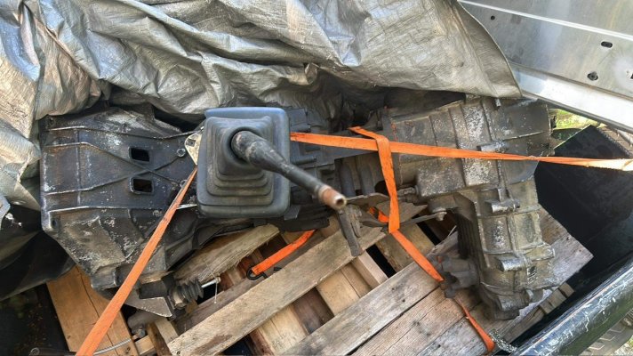

So I talked with the young guy who has the swap parts today.
The only concern I have is he said it came out of a fast 7.3..I then said what do you mean like heavily modified and he said he didn’t really know but that it was a fast truck in town..97 powerstroke
Should I pass?
It’s also been apart before because it had rtv at all the seams.

Orange rtv alert!!!!!
Actually that shouldn't be a problem, thats just the mating surface between the t case and the transmission itself. Makes it a butt to get apart, but also prevents them from loosening up.
The green on the t case output housing makes me think it was a wrecking yard part at one point. Evidence of the rtv makes it more likely for me.
I dunno. I'd probably get it and use it in a pinch.

I was thinking the same thing about the wrecking yard.
Thing is he has the whole set up and my tranny is acting up.
Rebuild or manual swap! Still debating

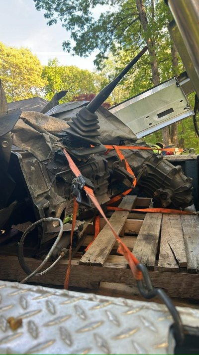

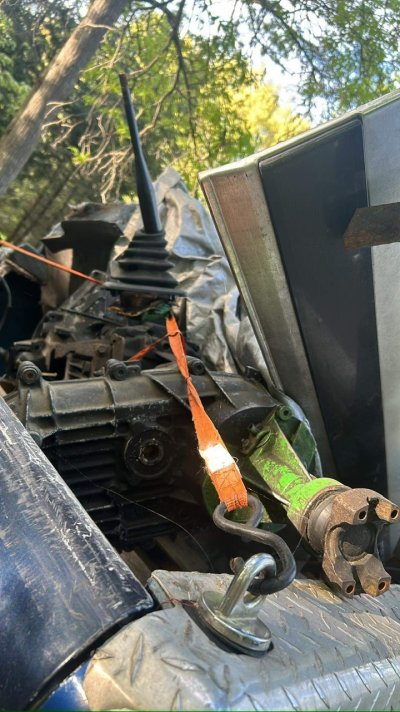

I found yet another swap kit. He doesn’t have the correct drive shafts for a cclb but he has everything else. 97 Zf5 and it’s been rebuilt at some point based on the tags (seller says) 150k miles and he’s asking $2500 compared to $1500 with driveshafts
But the other seller doesn’t know about miles and like I said it came from a fast 7.3.
4,209
4,793
You could ask the $1500 seller if he could pop the drain plug loose, see what the fluid looks like. If its not shiny and glittery its probably fine.
My transmission came off a truck with a big lift kit, huge tires, beat to hell, bad dual mass flywheel, dusted engine, so it was definitely abused. Still doesn't skip a beat to this day.
