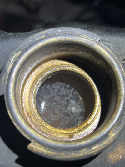

I do appear to be having contamination in the coolant. Check this out
