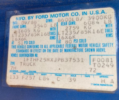

I just checked my door tag, Sping Code H for the front? A for the back, is that right? I googled spring code H with no luck. Anyone know what it means?

I can't speak for the rear springs; but, BEWARE if swapping front coil springs on these trucks.
My front axle snubbers were, and still are, about 1/4-inch from contact.
I decided on a pair of super-heavy-duty solve-all-your-problems raise-your-truck new front coils coming directly from Ford as an option or later add-on.
I spent what was to me an absolute fortune for the new springs and having them installed at the local Ford Garage.
It's not like I went to some big city joint where they grab your money and make you sit in some lounge while your vehicle disappears; I have known every man woman and child of the place all my life, else they wouldn't have been working on my truck.
I went to pick up the truck and one of the shop guys said "you are gonna be disappointed".
Those new front coils might be stouter and rated for more, but they did absolutely nothing toward getting the snubbers up off the axles; they didn't even raise the stance 1/16-inch.
My money would have been way better spent toward a good set of inside-the-coils air-bags.

Wow, sorry about that. Were you going stock or did you try to go up one or two lengths of spring?
