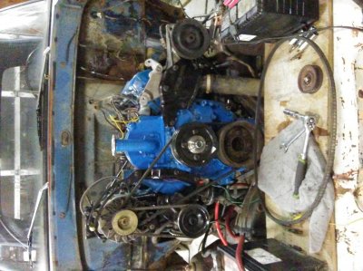

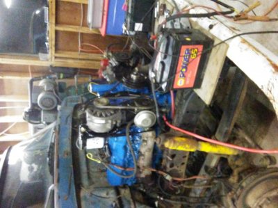

Thanks guys. I think I will pick it up and put it together. I am getting ready in the meantime.

Thanks. I have to get the turbo and figure how to mount it, and get stuff for the pressurized intake, like a hat of some kind to seal the intake. I also have to remove everything and have the frame straightened, so I get to grind my engine mounts off. Two steps back, one ahead.
