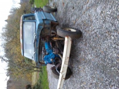

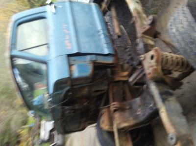

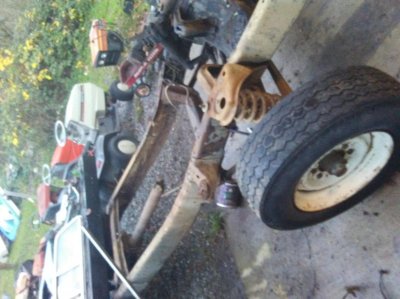

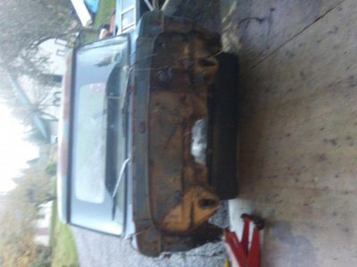

Got the cab off.

Great Progress! Looking forward to seeing how you go about the transplant so we can steal it for our project ;Sweet :rotflmao

Well I would be happy to help someone else out with what I have done. I have to pull my 79 frame around and get some guys to help me set the cab on, I just slid it off the side on a piece of 1x1 square tube. I have it sitting on my plastic truck toolbox from my 86 f250. I have a lot to do with work and school, and this weekend I have to go down south and I will not have time to do anything, which sucks. But maybe I can get a little closer.

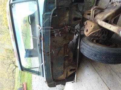

Got the cab on the 79 frame! Now to order $1200 worth of stuff from lmc.

How do the body mounts look for making that cab work?

Well the cab needs a little lift to work. It looks like the clutch is not going to work mechanically, so I am looking for hydraulics.
