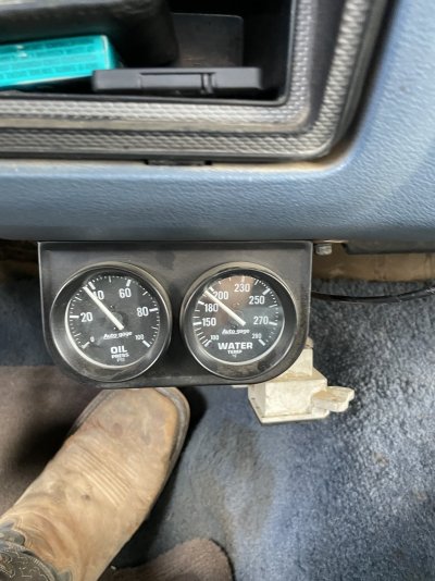

I did some testing, I guess that’s a nice way of saying I just stared at it. It hasn’t run since Tuesday night. I started it and stared at the radiator for about 10 minutes with the cap off and there were no bubbles. I know that if there are bubbles in radiator when the engine is cold then it is the head gasket. I’m still scratching my head. All the while, it has been running awesome. It was 102 here today and I drove around doing little errands and she never got hotter than 195 degrees. Boost is set at 13-14 psi. I’ve yet to get egt’s over 950. I don’t feel like I’ve been pushing any limits on anything.
