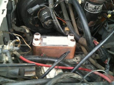

Im just going to be running a brazed plate heat exchanger, Just start and stop on regular diesel and flip over when the engine is up to temp... simple

Alex, That's more or less what i do. Heat using engine heat and start and stop on dino-diesel or even some home brewed biodiesel (with a thineer of cold weather)
