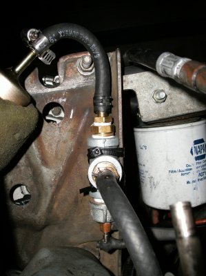

Biofarmer please, post a picture of your heater, it's worth a thousand words. Thanks.

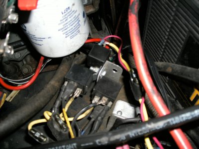

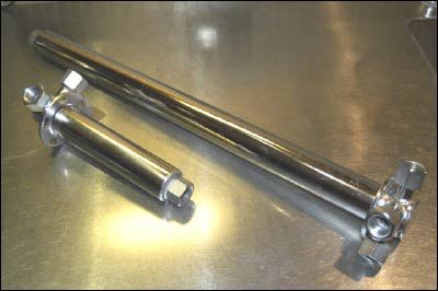

300 gal! :sly;Sweet Here's some pics, and one pic of the ever growing relay tree...

Is the heater grounded by contact with the filter bracket?
only partially/poorly- if you look closely at the first photo you can just make out the hexagonal formed copper connector that has 10ga. stranded wire bak to the neg. side of the passenger battery. The pos side has a custom made connector you can see pressed onto the bullet end and is fused and switched through a solenoid.
