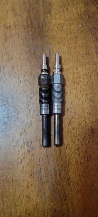

Wow these things really really cook, that was after about 8 seconds and you could feel the heat from a ways away.
