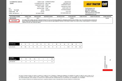

my pump man, knows what im running,,and didn't argue one bit, about rebuilding it..........my final wmo filter,,is 5 microns,,which he told me a pump can handle...then dilute two wmo,, to one dsl......
Mine has a 2 micron before the injection pump WIX 88315, good quality filter.
Yea check out my oil sample:sly
They called me really concerned! :rotflmao
