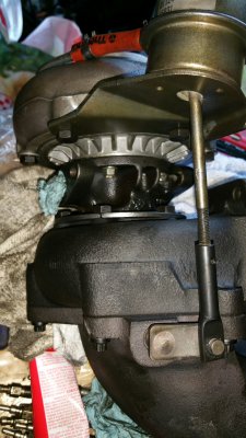

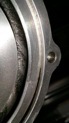

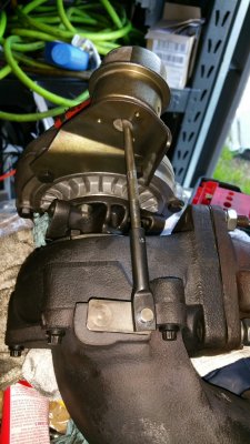

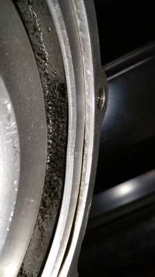

2 photos I took the day I went to install it October 31st, 2 photos of the housing as i removed it Saturday. I didn't find any pieces from the backing plate. All bolts were tight on receipt of turbo

I put this turbo on about 6 or 7,000 miles ago. I loosened the 6 bolts to clock it for the intercooler install today (you definitely have to loosen the pedastal bolts to get to bottom bolt type4 haha) and noticed it was hard to rotate. When it finally rotated I saw the orange gasket come out the back, hmm that's because part of the housing is missing. The compressor housing is also bent right there like it was assembled and tightened with something between the mating surfaces and it bent/broke it. Can I get a new gasket for this and run it like this? I don't like that it's cracked and bent. I spent a good bit of money for a rebuilt turbo and this has only been on the truck since the end of October.

It was cracked and broken in the pictures but that's how the core was received and it will be fine to run. I purchased a rebuilt didn't wait for mine to be rebuilt
