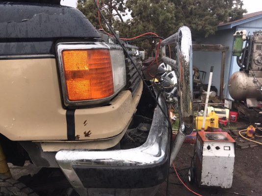

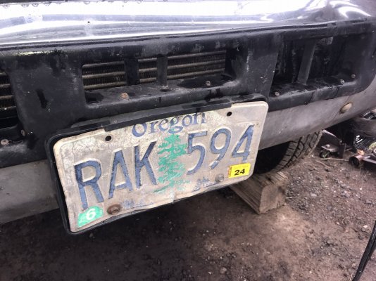

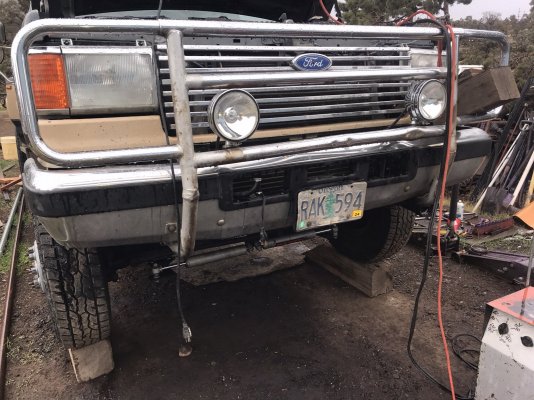

I went to order one of these bad boys finally and no online retailer had dimensions. So just in case I ended up getting one of each and seeing how they compared.
I'm actually surprised, the OBS insert will definitely let a little more air through. So I think I'll run that one. Amazingly, only $10 on LMC truck! Got some bed bolts too, and shipping was about $14 I think. A steal for how big this box is!
Edit: it occurred to me far later than it should have that I could have asked some of you kind folks for some dimensions...
The_Josh_Bear
Jun 1, 2016
2,298
1,962
Western WA
Apparently the OBS plate mount is special...mine is gonna be covered up by this strip. I wasn't expecting that, didn't look closely enough at the other pictures. Oh well, nothing a pair of snips can't fix.
The_Josh_Bear
Jun 1, 2016
2,298
1,962
Western WA
Doh, I posted an update for the wrong thread.

1mouse3
Nov 28, 2013
1,536
1,026
il
The plate mount will still work, it just needs a few thick washers to move it outward some.

Here's the damage so far, it fits perfectly now, just need to pin it in there. Got distracted with the water pump install and re-sealing my y-pipe, up-pipe and therefore crossover too. Stupid grinder got away from me ONE TIME just to the upper left of the plate. Gah. Oh well, it's not like it's a pretty truck.
I beat my old record for "how small can I get this cut off wheel before it's useless". Turns out, you can go past the cutting media and into just fiberglass. I feel like I knew that but haven't tested it in years. :joker:
