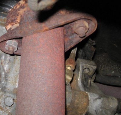

This is the port you want (behind exhaust pipe)

Or take it from the back of the block. There is a small plug in the back of the drivers side of the block on the bellhousing flange. Not on the adapter plate, but the flange that is cast into the block that the plate bolts to. Its about half way up the side of the block and almost where the exhaust manifold flange is at for the crossover pipe to bolt to.
If you still cant find it post back and we'll help ya out.
No matter where you put it be sure to clean that hole out good and crank the engine over afterwords to flush out all the coaked oil you've broken loose. If you dont clean the hole out you'll regret it, just ask Justin.

HA! SUV went a step farther and even showed you the port Im talking about. lol
