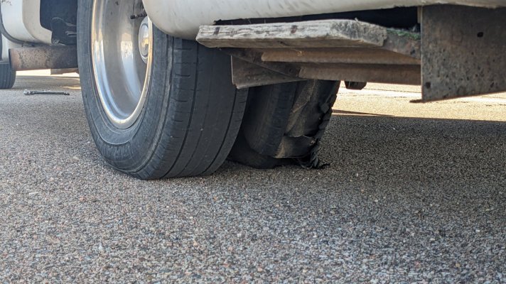

I blew the inner right dually tire on the motorhome shortly before I sold it, at 55mph. Zero loss off control. And I was able to go another 1/2 mile to a wider shoulder area along the interstate. I was heading for the nearby exit but the very wide shoulder came up. So I definitely recommend dually for heavy RV type setups.
And yes I did also stop using the other that was suddenly bald and about to blow too. I bought an odd sized tire i got cheaper at Walmart, put it on the front, put that on the rear along with the new spare I was carrying. The bald one was the "spare" for the last 700 miles or so before I sold it.
