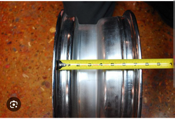

I do have a set of rims at home. Had my old man measure them, they're 7" from bead to bead. I always referred to them as 'boat rims' because they look like they belong on a boat trailer.
Looks like I might be using those.
Not mine, but a photo of what they look like

Be sure you are measuring correctly - inside the flanges.

Thats what he said he did, I'll double check it when I get home.
These rims came with an f350 I bought years ago to part my truck together, they've been just collecting dust since then.
