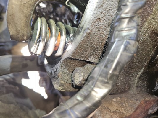

I bought an inspection mirror on the test drive yestersay, as I admittedly didnt have one yet. Went Occams razor and assumed that shard was lodged in something and causing the sounds I was hearing. Everything else looked okay straight off.

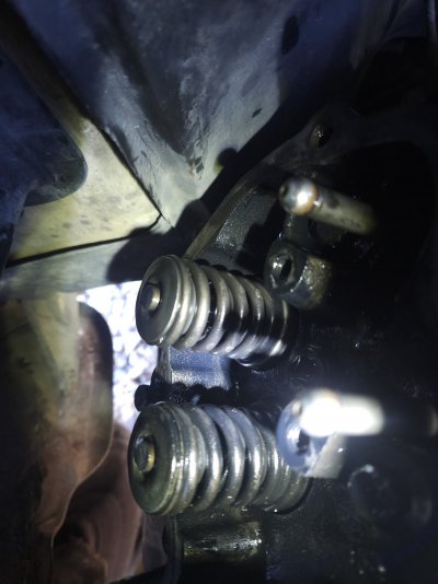

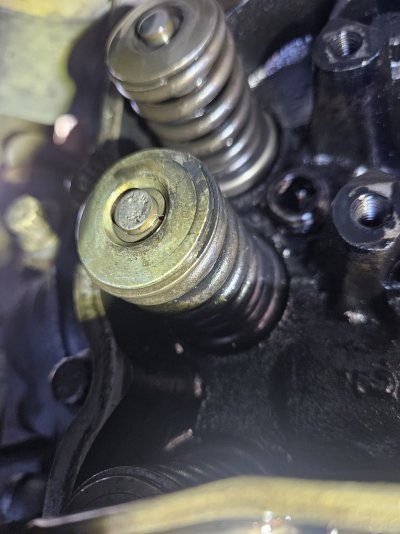

I noticed yesterday that one set of valves has an orangey or brassy looking part that takes up most of the internal diameter of the spring. I assume all of those valves should have one, but its missing on cylinder 7. What is that part? I dont have a spring compressor but i could try to get or make one. Seeming more and more like Ill have to.
