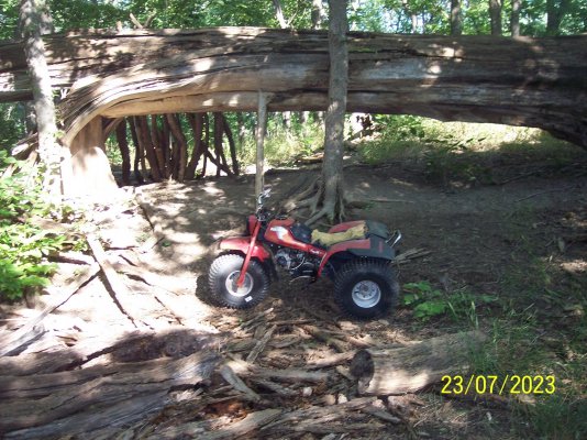

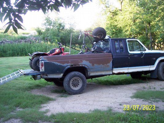

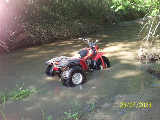

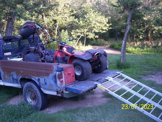

I had to take my truck on a little rescue mission for myself. I rebuilt this three wheeler in my driveway from looking like it was ready for the scrap yard to a rideable machine. I forgot to check the axle locating bolts and three out of four fell out so the chain kept coming off. I got to push the thing for probably close to 1/2 mile until I could get clear of the trees. I bet that I'll sleep good tonight!
