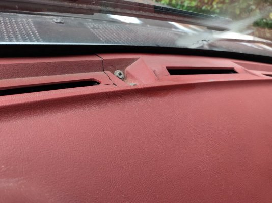

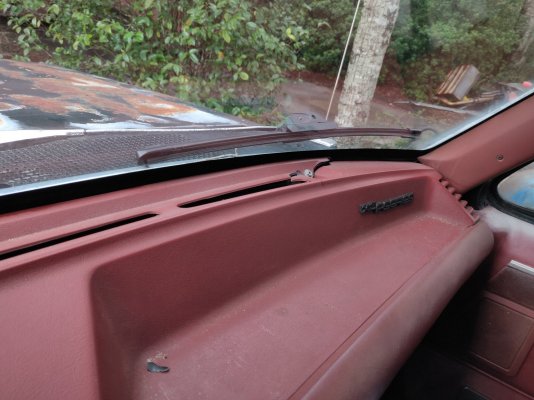

Well.....you'll never be able to say that again. This is the hopeless dash in my bricknose tow truck.
