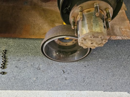

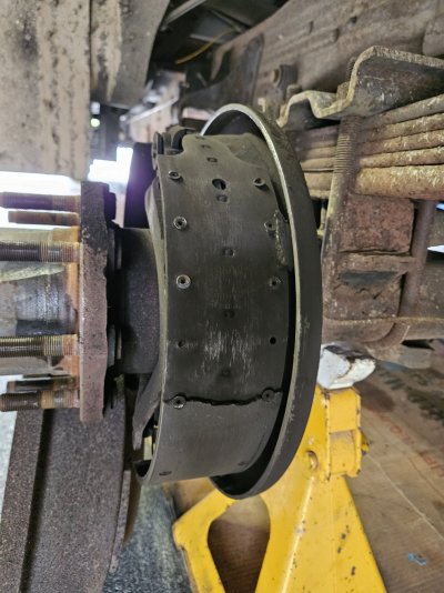

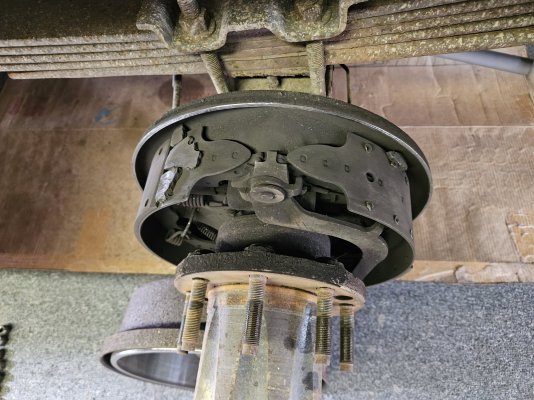

The shoes were @75%.
:cool: Moral of story , don't age cure frictions...
