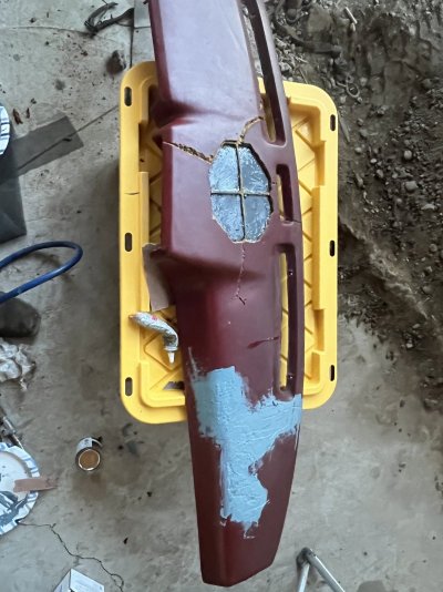

This is one of the few things I hate about the bullnose interior
Yeah...I have the same situation...at least it made me put some new speakers in behind the doors...and...I figured out which wires do what with the factory radio...
It would not be so bad if there was an affordable alternative...
Some body oughta make a dash pad that doesn't cost an arm and a leg...
Back in the 70's we woulda just covered it with a shag carpet remnant outta the carpet store dumpster...
I don't see a problem, I see a serviceable part. Now if it was a 87 or later, you'd have a bunch of busted and cracked plastic that you couldn't do anything with. AND notice how handy it is that you can remove the dash to do clean wiring for stereo and gauges. Dude, we got the best! Just look at our stylish stearing wheels!

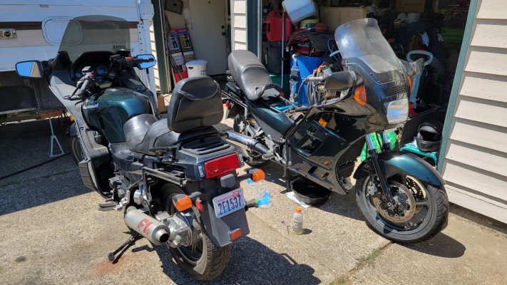

What kind of bike did you get? Pictues?
Picked up a 1998 Kawasaki Concours in green for my old man, to match my 1998 green one.
His has The F1 pipes. They're coming off, they're far too loud.
