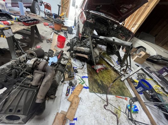

Oh yea all good for me, I was just rolling it backwards so not like I was under it or anything, pretty damn loyal cherry picker I’ve done 6 idis with that on 1/4 ton interesting why it gave on 1/2 ton

This just confirms that when I pull my 6.9 to clean everything up, I WONT be doing it with a chinesium cherry picker.
Is the motor okay?
Not really the cherry pickers fault, I’ve used it for idis on the 1/4 setting too many times I’m sure that’s what the reason was,
I don’t care about the motor it’s got rod knock or some sort of malice
I was able to shove it so it landed on the oil pan so hopefully I can still salvage stuff

Glad to hear you are ok.
Looks like what I see, it bent the leg where you fold it up for storage.
But when things go wonky and move in directions they were not designed to go, other things get tweeked along the way.
I think it has 6 wheels, right? So should have a wheel under that point.
Iam always concerned about the Ram giving out with the weight hanging on it.
I always wish these things had larger castors so they roll easier with the engine hanging on them.
Trying to move one, and the engine swings, puts stress on the frame.

The center wheel is off the ground a hare when the leg is down. I have the same cherry picker.
Still odd that it failed on the 1/2 ton point. Wonder if it had rust internally and failed?
You should cut it open, for science!
