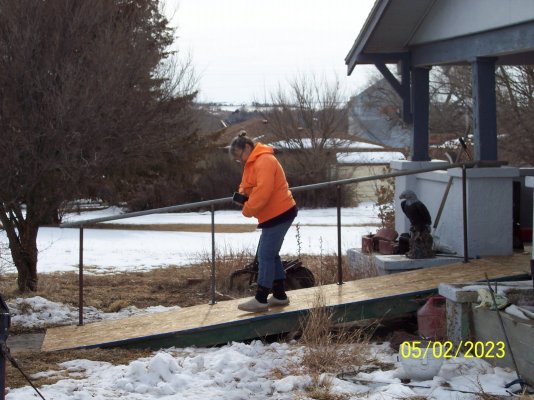

I finally finished with the wheelchair ramp project. They both decided that they wanted a handrail along it for her to use. It isn't pretty, it isn't square, but it is finished. Here's a picture of her leaving. She forgot to use the handrail that she wanted so badly. Yes she is that type.
