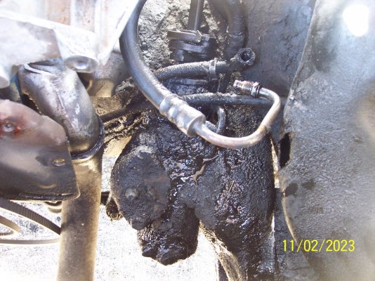

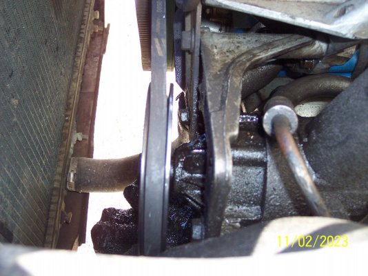

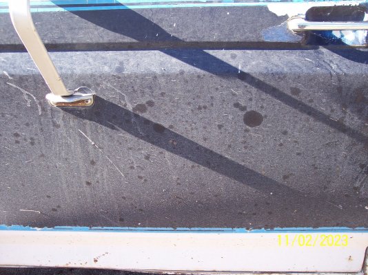

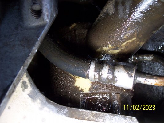

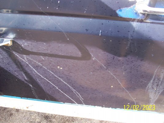

Today was supposed to be clean out the garage day which kind of extended to the storage shed as well. I also found out last Monday evening that the power steering had a bad leak. You know that it's a bad leak when you're getting oil spots on the driver's door that weren't there before. I wanted to fix that today too. After I get back from Texas, I'm going to buy a Red Head steering box since mine is out of adjustment. They recommend new power steering lines. I'm also planning to order a new/reman power steering pump and probably the steel cooler that runs along the crossmember to have a whole new system. I really didn't want to buy a reman pump and then turn around and buy another one in another month or so. I did happen to have an extra one sitting around from a red truck that I bough a couple of years ago just for parts. I thought that it had to be better than what was on there. I finally got it swapped out and it sure worked better. I shut off the engine and looked at the pump to see that same type of oil leak that had been coming from the other pump. Then I realized that it wasn't from the pump, the high pressure line appears to be bad. If you look closely at it, you can see a deformation in the rubber part where it looks like the crimp is no longer holding. I guess I get to do it again tomorrow. At least it's not a lot of extra bolt turning for me. The pump that was on the truck did need to be replaced. I grabbed the pulley and it has about 1/2" of in and out play in it so the pump was probably almost done for anyway.

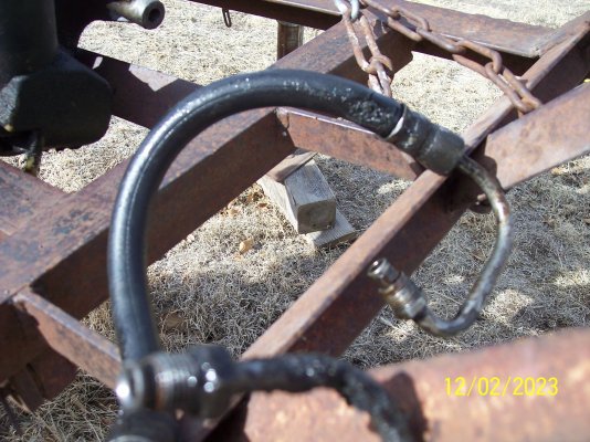

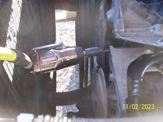

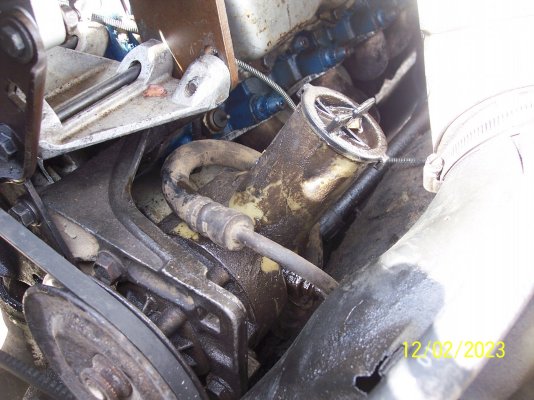

To finish this part of my power steering saga, I got it fixed today. I grabbed another used high pressure line. After forgetting how much fun this is to replace at the steering box, I definitely have to give Cubey two thumbs up for doing that to his RV a couple of years ago in a parking lot or campground somewhere. After I got the line off of the truck, I think that I was wrong about where it was leaking. Although it does looks like the crimp had let the hose slip, I'm pretty sure that the hose had just rubbed through on the power steering pump. I finally got it all done and it works great. It actually feels like a Ford truck from this era instead of a front wheel drive car. No more new puddles in my driveway and, after I wash it again, no more oil spots that mysteriously appear along the driver's side.
Happy trails until I get to install a Red Head and all of the other new parts.
