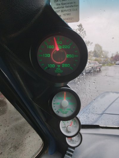

Me I put in a isspro ev2 gauge to replace the isspro ev1 gauge. Worst part is after I got it out I realized I had a bad connection in my own wiring. Thought I had it sorted then test drove and it failed again. So I cut the connector out and but connected it.
The pins lost tension on the cheap Delphi knockoff connector.... grr
Anyway oil temp should be back working, and am trying to get my aftermarket wiring bulkhead where it goes through the firewall to seal and not leak rain water.
Supposed to rain all next week so we shall see.
