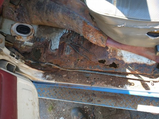

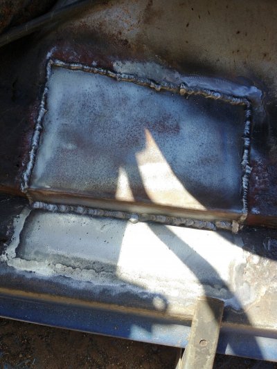

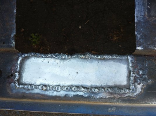

Running a big trailer harness cable in the "new" truck. I want to path it under the trim piece on the drivers side, up under the dash board. Pulled the trim piece up and the flange under it came with it. Pulled the carpet up and the entire area underneath was caked in wet mud, probably half an inch thick of old dirt, all soaking wet. I havent driven this thing in dirt in the year that ive had it so it must have all been in there from the quarry that it used to live in. Scooped out about a gallon of dirt and rust to find holes rotted thru the floor. SO, heres the first patch panel. Shielded root side, full fusion all around. There was an overlapped seem on the back that I couldnt get to to clean up so I had to weld into the rust there. Managed to build enough solid metal to grind it down into a nice shelf to weld the next patch on to. Left and right sides of the patch are extremely rusty and I really just welded them in to have some solid metal for the next patches.

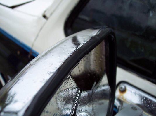

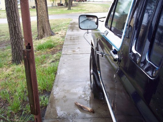

Out of habit, I back into my driveway. When I walk the two blocks between work and home, I walk between the passenger's side and the house. I had a little W T F? moment when I went to open the driver's door after lunch. We had some storms roll through today. It could have happened this morning or even last night. So I got to buy a replacement mirror today.
