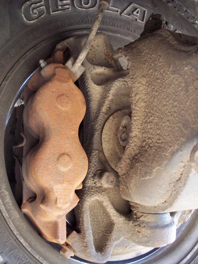

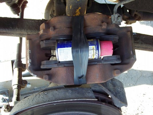

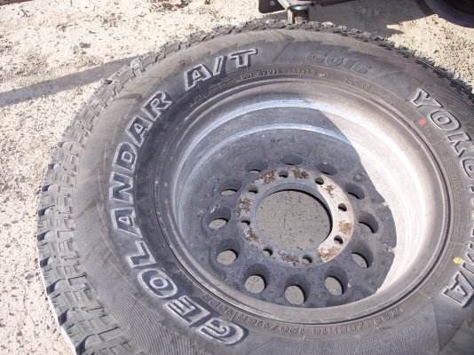

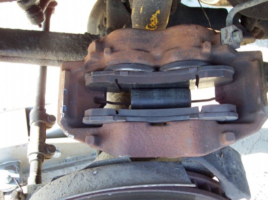

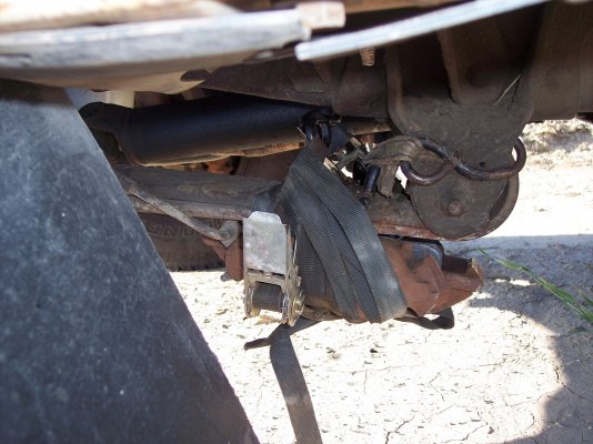

I just took it grocery shopping. Nothing too unusual. What was unusual was what happened on the way home. As I was going down the highway, I felt a quick shake from the truck and felt it in the steering wheel. It felt like I ran over something, but I couldn't see anything in the mirrors. I pulled over on the shoulder and looked all around the truck, but I couldn't see anything. I wanted to get off of the busy highway so I drove about 25-30 for the 100 yards to where a dirt road met the highway. I looked all around the truck again. I even checked the driveshaft for play. It's more than it should have, but what it's always had so that wasn't it. I gave up and decided to drive home slowly on the dirt roads. I turned around and drove back to the stop sign and thought that I heard a noise when I pushed the brake pedal so I backed a slight hill to roll down. As I was backing up, I heard and felt a loud "bang" that sounded like I had backed into something, but nothing was there. About 1/4 mile farther, a dirt road went the other direction from the highway toward home so I limped along the shoulder to that road. After turning off of the highway again, I shut off the engine and hit the brakes a few times. I could hear a grinding noise for sure and I thought it was on the driver's side. I crawled underneath the truck and found that all of the hardware that holds the caliper on was missing on the driver's side! I put on my MacGyver hat and decided to pull the caliper off and drive home. After I got the tire off, I took a socket out of the set that I carry to change tires and drove it between the pads to keep them from expanding. Then I took a small can of WD-40 and taped it to the caliper to hold the socket in. Then I took a couple of old, nasty ratchet straps that I had along and tied the caliper to the back of the leaf spring. I put the tire back on and drove home taking it easy on the brakes.

Hey! I didn't watch MacGyver for nothing!:cheers: All I can really do is laugh. I made it the last 17 or so miles home. Tomorrow, I'm either going to buy some new hardware or take it off of another truck. I forgot to mention that I had seen the piece that holds the lower slider in the mirror when I was driving along the shoulder. I walked back to pick it up. A REALLY nice looking young lady stopped and offered me a ride back to my truck so of course I accepted. If I was about 25 years younger, I would have been all hot and bothered over her. It wasn't exactly sweltering with a high temp of about 80*, but she was still showing most of it all off.

I saw a guy two weeks ago with a early 2000’s F-150 driving down the freeway with his front drivers side caliper dangling from the brake hose. Still trying to think how that got past the rim and rotor but it did. Tried honking to get his attention but he did not look my way.

Mine did fall off when I took the tire off, but not before. It was having too much fun digging grooves into the rim to leave the party at that time.
