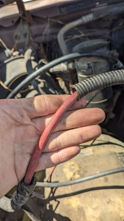

Hate to start a thread and couldn't find it. What's the glow plug cable gauge?

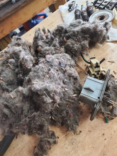

That's my truck hood liner "repurposed" as housing for an extended family of rodents.
It was packed into fan and resistor.
Resistor plug melted. A vacuum, a long time of compressed air on the fins and fan blandes, new resistor and harness.
Blower has been "acting up" for years then stopped entirely.
Rodents left without paying last months rent :mad:

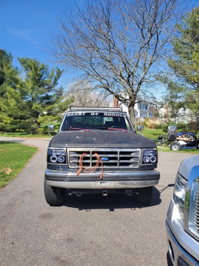

Finished lifters!! 2 years! Chuffs of smoke gone, I still feel like it's louder than most but I guess I'll see at the rally.
Need to time it and put other mirror on. During test drive I really liked all that visibility, even with no trailer. It was fun pulling it out of shop though haha.
Next is
make new battery cables,
tighten parking brake
Install cupholder that 3d Ford parts finally made
Replace batteries (mine are from 2017)
Then daily drive it until rally

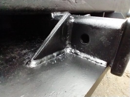

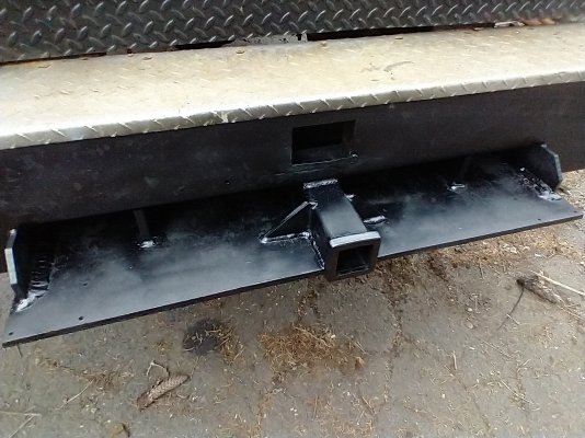

Finally got around to rebuilding my trailer hitch assembly on my F-SuperDuty. 1/2" thick bottom plate 42x24". 4 vertical gussets measuring 1/2"x20". Hitch tube is welded to the square tube top member front and rear and is welded into a "C" channel rear bar which is then welded into the rear of the bumper. No pictures of that fitup and weld. basically the C channel was hammered thru the other side of the bumper and then welded so that trailing force will have to pull a 30" tube thru the bumper wall to get the hitch tube out.
I was especially proud with how that triangular gusset came out, weld is continuous all the way around the tube and gusset, about 12" non stop at 26V 380ipm.
