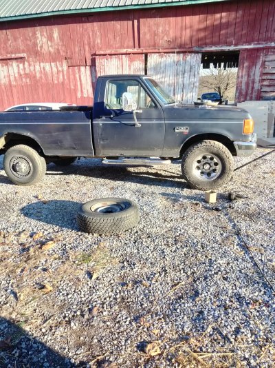

So I spent all yesterday morning in a junkyard trying out how to remove 32 security lug nuts that nobody has a socket for including the yard. It took 4 guys, a loader, and 3 hours. I couldn't believe anybody would put security lug nuts on every single lug! Anyhow, these are 12.50x35s on 17" rims. I wasn't expecting to find these in the yard. I paid $250 for all of it. Rear tires are brand spanking new, but I will get 2 new front tires because they were out of alignment on the truck they came off of.
I wanted the rims for the crew cab, but there's no way I am running 35s with 3.55s on the tow rig. This truck is also 3.55, but it's just my daily now, and I am not letting these tires go to waste. They look darn good on there too!

I have to agree myself. For me personally, I don't want to try to experiment with different tire sizes. I feel that the 238/85r16s are just fine for me. I've had bigger tires on the Bronco. Not much bigger, but they were 285/75r16s. I feel that they were ok for that, but they were mostly for looks in my opinion. The exception will be on my Red Truck. I have 235/75r15s on there now because I couldn't stand the thought of the 215/75r15s that were on there from the factory. It needs two tires right now and after I do the IDI swap to it, it will be running 31x10.50r15s. That's the size that I had on it when I first started driving it (I stole them off of the Bronco after it's IDI swap). I think that they looked good on there, but I mostly want them for the lower RPM while driving down the road without overdrive.

Yup, I didn't like the idea of fooling with the gearing on the crew cab. If it had 4.10s, it may be ok, but I like the gearing the way it is. Another factor was weight rating on the rims. I don't know what the rating is on these aluminum rims, but I am sure it's quite a bit less than the steel wheels, which is no good for the tow rig. It actually works out great, since the new 16.5s that were on the 6.9 will go on the crew cab since it needs tires. This way I only have to buy 2 tires instead of 4.

Locking lug nuts are easy to remove. Just hammer on an old impact socket on and spin them off. Done it many times. People lose the keys all the time. That's why they put them on all the lugs. They aren't hard to remove.

There's a bit more to it. These were 7 point tapered nuts, recessed flush with the rim wall, and way over tightened, and stripped out from somebody else trying to beat sockets on them. Not easy at all. I threw all those crappy lug nuts out, and have a new set coming tomorrow morning.
BTW, you are welcome to the old lug nuts,lol

That makes it more difficult. I try to find a socket that fits tight on the tapered part. But if they are overtightened it's much harder. I also usually throw them out unless the customer wants them back.

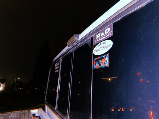

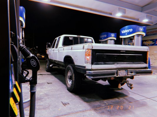

I spent my evening polishing my wheels and pressure washing the frame. After Christmas I plan to remove the bed and paint the frame and clean up some of the wiring and what not. I did this when I was 16 but I want to do it better now. And now I have the time!
