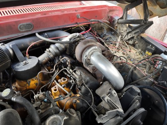

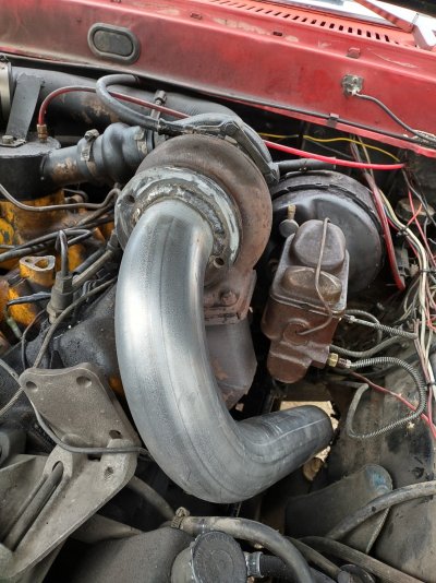

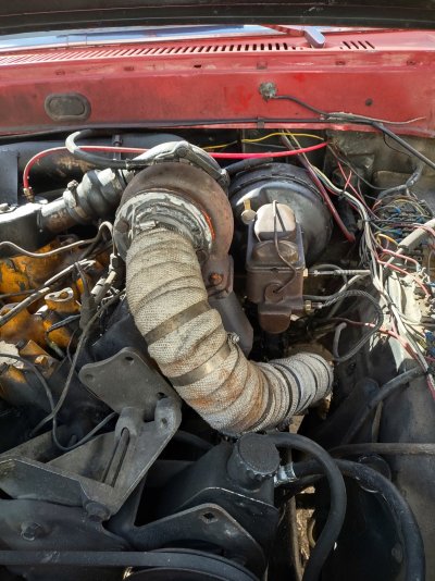

I'd put a dual diaphragm booster in, and a bigger master cylinder, guts wise, ended up 1 3/4 inch longer so cut the old pipe off and made another one with better flow. Picked up some earlier boost, and a bit more responce. Brakes work better too.

From what I remember, that looks fairly similar to the early Hypermax that I saw. I certainly don't remember the down pipe running back and over the top of the engine. The pedestal even look closer to what I saw too.
