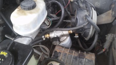

Maybe something like this ...:dunno
I just plumbed a cooler and that filter into my power steering setup.
One thing I learned is the hydroboost return only functions when depressing the brake pedal...hmmm..
So now my setup goes....from steering box to crossmember line....to filter....to cooler...to fitting on pwr str pump where the frame loop Used to connect too.
Hot oil filters better I figured.
It will get changed out in while...see if the clean TDH fluid works ok for pwr str fluid???? :dunno

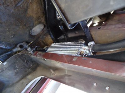

I have this small cooler on the return line from hydroboost. It is behind the rectangular opening in the core support where the factory intake air supply was attached. Oops , large picture. Rt click on pic and select view image.
I am wondering...based on the observation I had yezterday...that return line is not constant flow it is intermittent flow when brake pedal was pressed
That being said maybe I have a fault in my setup.
May want to look into that because it may not be doing much if bypass is not constant flow.
I didn't know that, so maybe my setup isn't so good. I really don't use my brakes all that much, but it is good to have effective brakes when they are needed. I should shoot the lines in and out with an IR thermometer. I know the input line is pretty warm.

Sorry to be polluting hi jacking yer thread man but this is good info...
Ya shoot it with IR..but again if constant flow great but if intermittent its of no significant bennefit to plumb on hydro return.
I was initially going to plumb my cilter on hydro and cooler on steering return...but when I was attempting to evacuate old fluid by ONLY removing hydro line nothing came out ....unless I would press pedal....so I chose to filter and cooler on steering side of return.
One thing...I noticed fluid change and fpush solved an issue I had with my steering that felt like an over center tie rod or something binding...now it is smooth...
