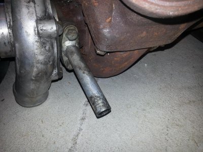

Yes! It helps alot! One more question, what is the length of the tube? Thanks for taking the picture.

Thanks for the help bullfisher and OLDBULL8. You both made the fabrication job a lot easier!
