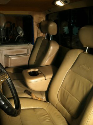

Some remeber the smoking deal I got on the entire contents of a 2003 F150 Super Crew with the Lariat trim and leather seats right?
Well I finally got around to getting themm installed and WOW what a difference!!:love:
Utilizing the drivers seat brackets and shortening them down an inch, I then made new mounting brackets for the passenger seat.
I still have to get the seat heater switches dug out and installed yet but the wiring for the 6 way and butt warmers are all wired in and ready to roll.;Sweet

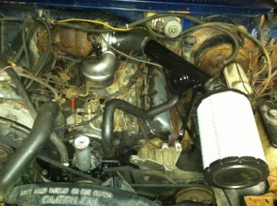

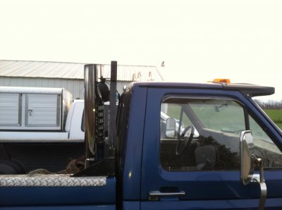

I did some "will work for parts" swapping and ended up with a complete 088 ATS turbo system. So that got installed about 2 weeks ago along with a 6" chrome stack up thru the bed.:sly
Wasn't really a big stack fan but man does it sound good now and the kids want to open the rear slider just to hear the exhaust!LOL
I'm struggling with the fact that I still have to turn up the fuel since it's still stock and can put out 13 psi of boost at 650 on the pyro!!!:eek:
With a stock A series 6.9 with head bolts I cring at turning higher numbers with more fuel and the fact that it boosts harder that Goldie.cookoo

so how did the seats fit width wise, i am casually looking to replace the buckets with a bench for more seating capacity and it might be nice to upgrade. i need to find some gray ones though.
Same width installed Jared. It's like they belong in there.;Sweet
It's now got me wanting a set for Goldie.

Hey Gary, momma would like these seats.;Sweet
They weren't that hard to install either. The worst part was taking the passenger seat in and out several times while fitting the brackets.:puke:
