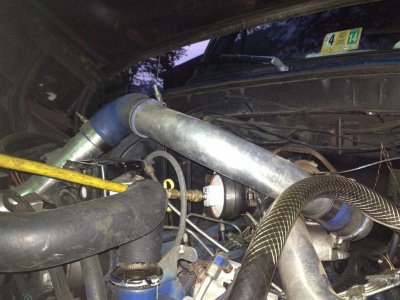

I did the test last night. I put 15psi to the system and could not hear any leaks. When I cut the air supply the system bled the pressure off slowly over 30 to 45 seconds. I looked for exhaust leaks too, no soot anywhere on the up pipes.
The issue is so annoying I am considering swapping my manual for an e4od. I need to update my sig, I recently swapped a sf-42/zf-5 in there but this problem was an both transmissions. No guts below 1K rpm.
