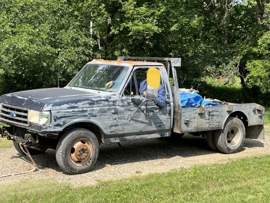

Pics of the truck. Please excuse my crappy photography lack of skill.

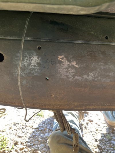

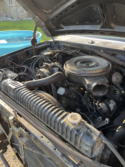

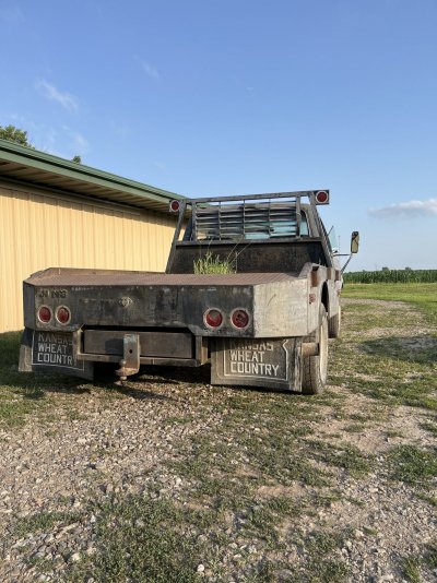

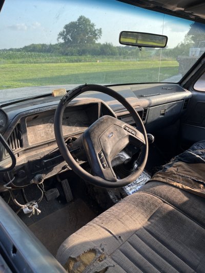

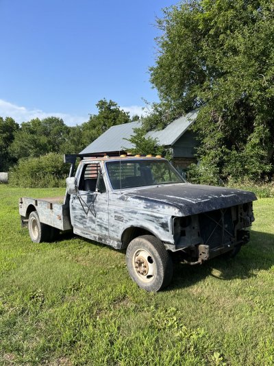

Strange that it would run with the fuel solenoid not wired up. Turns out that the cold idle switch wire was connected, and the fuel shut off solenoid wire is botched. Put a new one on. Runs way better now. :Thumbs Up Still won’t stay running but when it is running, it moves along pretty good. Looks like nature planted a garden in my gooseneck ball hitch.
In the third picture, you can see that many of the wires on the starter solenoid are disconnected because sparks fly if they are connected.

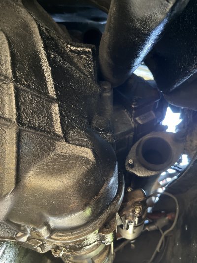

Fourth pic shows my missing up pipe.

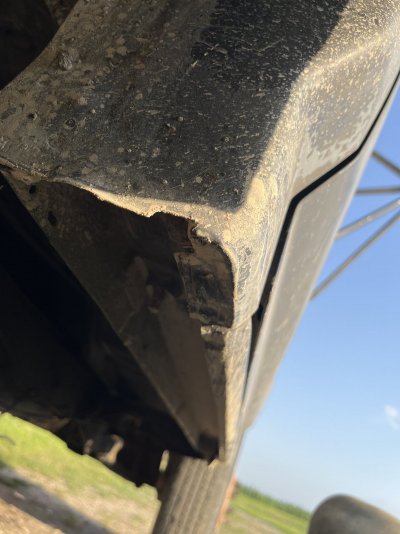

Fifth pic is cab corner. Oh, and that is not surface rust on the frame it’s dirt mixed with oil. Of course, there is a little bit of surface rust in spots, but still really good as far as that goes.

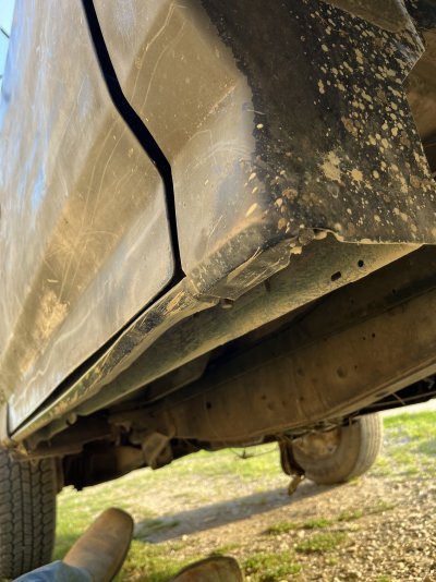

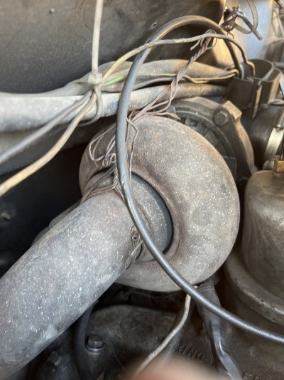

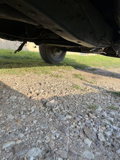

In the third pic on this post, you can see all the wiring hanging down… MINT!!! :rock:
The baling wire on the turbo is also real minty.
There is surface rust on the roof, I presume from having been rained on with the paint stripped off. I sanded down a spot, and it is perfect under there. Couple of dents in the roof too, nothing too bad though.

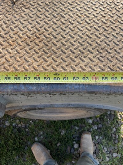

My truck has a setback rear axle. 60” from back of cab to center of axle. Bed is 8 1/2 feet long, but only 90” wide. 6” from side of cab to side of bed. I wish it was wider, but of course, the rear axle being narrow dictates that.
