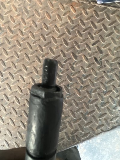

Truck needs injectors, plan on getting them from Russ.

I got a couple of injectors out of my white 6.9 that do not seem to have metal in them that I will put in my 7.3 for now

One of the injectors that was already in my 7.3 was a G code. The rest are B codes. :idiot:
15,051
14,149
That probably doesn't matter these days. Each rebuilder sets them to his own specs no matter what's stamped on the outside. The only way that it may matter is if they're original and if they are, they're probably pretty worn so it still won't matter.

This injector was/is trash

So I ordered a set of new ones from Russ today. Finally got rained out, have enough time for my own projects lol. Got the afternoon off, was replacing input shaft and flywheel on a concrete truck this morning.
