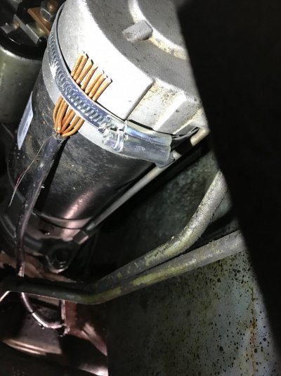

try to improve the ground connection

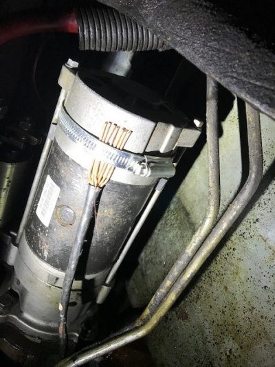

It was not a joke. The local auto electrician told me, there is a lot of resistance in the old starter motor, and it really made a different with a piece of cable and a clamp, try it and you will never take off the cable again .
Looks like the f350 I fixed years ago. That thing never would start very well. Compared to mine, you could tell it did not crank over fast enough. It had a rebuilt starter on it, still did not fix it. So I took the starter off my truck and put it on the f350. Still cranked slow. Got to looking at it, the area where the starter bolted up was very corroded. I took a 4 inch grinder and reached up in there and knocked all that corrosion off. Bolted the original starter back on and it was fixed. Poor starter grounding was the cause. Looks like your added wire to the outside of the starter just goes around the problem. Whatever works.
