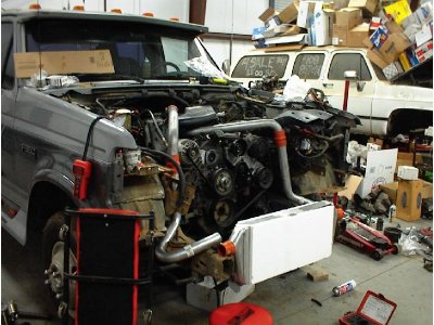

you have the piece that's no longer being made by ATS.
if you can handle the cost of $1300, call ATS and they will sell you the rest of the kit that will bolt right in.

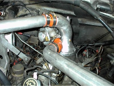

To be clear, the ATS piece that I have is the big tall ugly piece with the bolt running through the middle of it that bolts right on top of the intake manifold.

this piece right?
That is the piece.
Banks makes a cooler for the 94-97 powerstrokes. I was thinking about retrofiting it to my IDI since they are the same body style and building my own plumbing.
