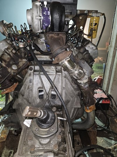

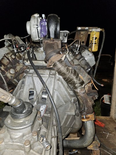

A handy dandy view of what a Banks gen1 looks like from the back when installed. Although this is a van specific kit, with a long snorkel connecting to a cylindrical k&n filter on a bracket up front just under the hood.

Ah the great part about vans, the access the doghouse allows for!
