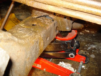

So my bud who likes to burry his truck in 4' snow drift calls me this morning to telll me he has broken the IFS housing drivers side arm near the punkin.
I have one from an 85 F-250, will it work on a 96?
We have to use his gear set and hub assembly since he has the larger hubs as mine does not.
Gonna try to tackle this tonight as we're getting more snow today and it's his plow truck.

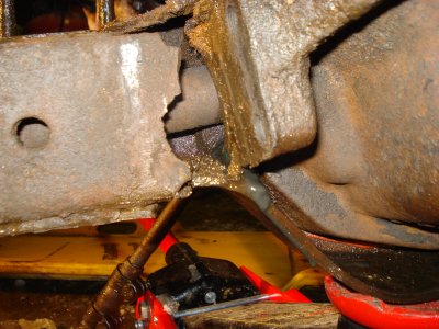

Yup 50s are a totally different animal.
But here's what one looks like that has failed.:eek:

MUDKICKR
Apr 15, 2007
1,426
NITRO WV 25143
wow, that is wild. id never thought something like that could ever happen. but i always know anything can happen. i dont know if i would try to repair that, but knowing me i would try. but yea the best bet is to replace that. also i wonder if something inside the carrier let go to put enough strain on it to break. but i guess it all depends on how hard he hit that on something (and how many times). good luck on the repair.
