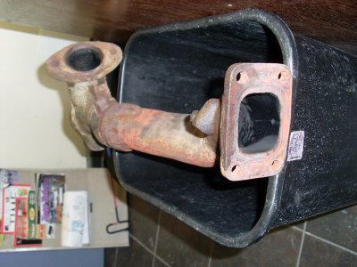

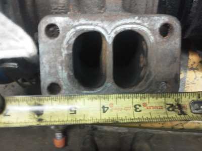

Can someone show me the exhaust flange that is used for the Banks system? I'm curious if they were lazy enough to use the entire mitsubishi turbo, if the bolt on flange is in fact a mitsubishi flange. If thats the case the sky is the limit to what you can bolt onto that flange.

a WG banks turbo on the exh mounting is a T3 mount.
